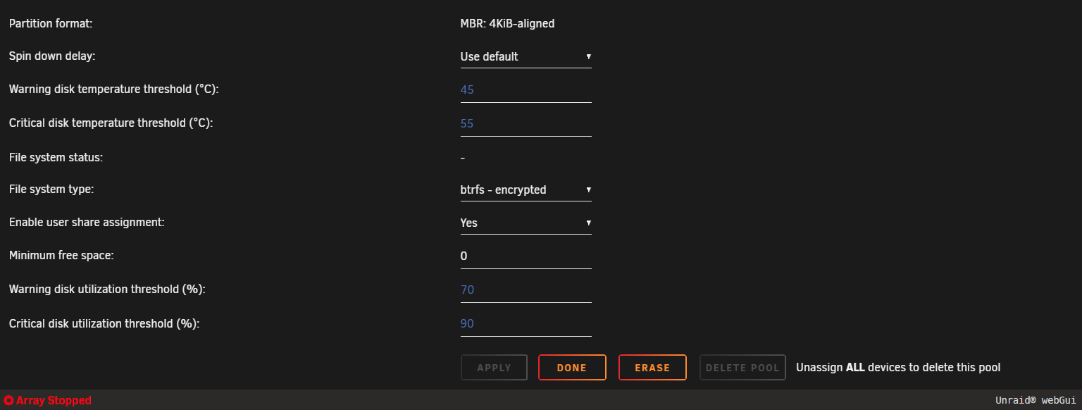

Note: if you have already (re)Formatted using previous 6.9-beta release, for SSD smaller than 2TiB the proper partition layout will appear like this on the Device Information page:
Partition format: MBR: 1MiB-aligned
For SSD larger than 2TiB:
Partition format: GPT: 1MiB-aligned
Here's what's in this release to help facilitate re-partitioning of SSD devices:
An Erase button now appears in the Device Information page.
The Erase button may be used to erase (delete) content from a volume. A volume is either the content of an Unraid array data disk or the content of a pool. In the case of an Unraid disk, only that device is erased; in the case of a multiple-device pool, ALL devices of the pool are erased.

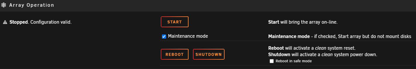

The extent of Erase varies depending on whether the array is Stopped, or Started in Maintenance mode (if started in Normal mode, all volume Erase buttons are disabled).
- Started/Maintenance mode: in this case, the LUKS header (if any) and any file system within partition 1 is erased. The MBR (master boot record) is not erased.
- Stopped - in this case, Unraid array disk volumes and pool volumes are treated a little differently:
- Unraid array disk volumes - if Parity and/or Parity2 is valid, then operation proceeds exactly as above, that is, the content of only partition 1 is erased but the MBR (master boot record) is left as-is; If there is no valid parity, then the MBR is also erased.
- Pool volumes - partition 1 of all devices within the pool are erased, and then the MBR is also erased.
The purpose of erasing the MBR is to permit the re-partitioning of the device if required. Upon format, Unraid OS will position partition 1 at 32KiB for HDD devices and at 1MiB for SSD devices.
Note that erase does not overwrite the storage content of a device, it simply clears the LUKS header if present (which effectively makes the device unreadable), and file system and MBR signatures. A future Unraid OS release may include the option of overwriting the data.

4. Verify no data is left on the pool, Stop array, click on the pool, and then click the Erase button.
5. Start the array and the pool should appear Unformatted - go ahead and Format the pool (this is what will re-write the partition layout).
