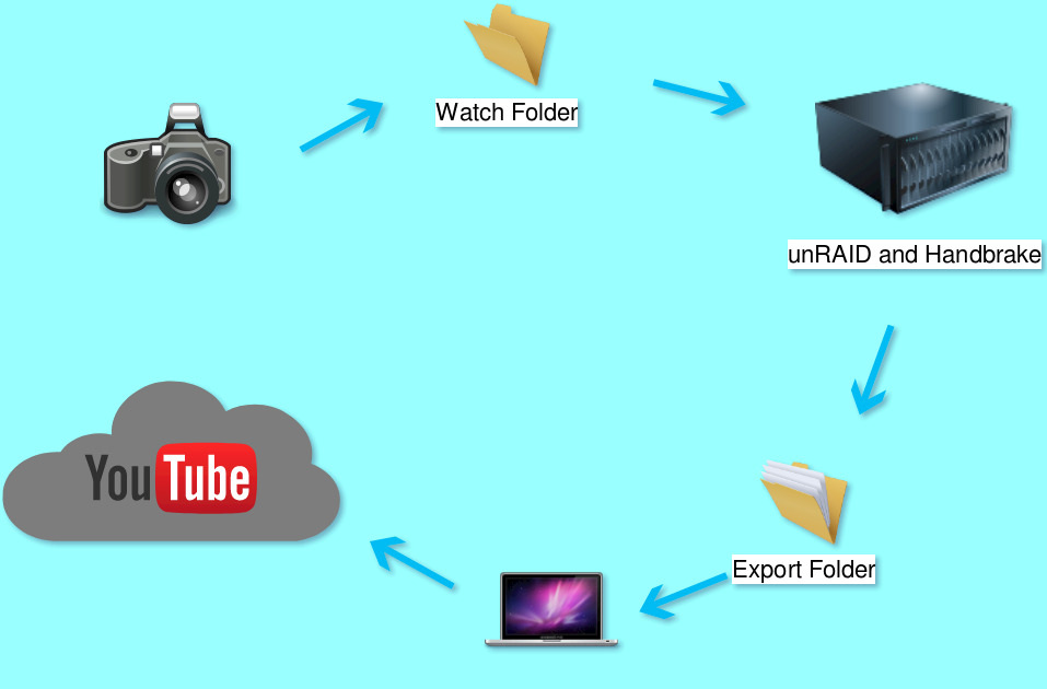

Well, I guess it makes sense to talk about the big picture setup first. I feel like I should just diagram this….
![Untitleddiagram1](https://craftassets.unraid.net/cache/awss3cloudfront/406/UntitledDiagram1_c5a520ad91c6adda23c43d756a4a8dd6.jpg)
As seen above, this is basically the workflow. I have to manually pull all video from the camera into the watch folder that is on my Unraid server. Handbrake see’s that new files have been placed into the folder and begins transcoding them into a 4K 60FPS MP4 file. When Handbrake is done, it puts the finished video into the export folder, from there I can easily grab those files and import than into Final Cut Pro X at my leisure. Then of course once all editing is done, I will just upload that to YouTube or where ever on the internet. So that is the 1000 Foot level overview. Let’s go deeper!

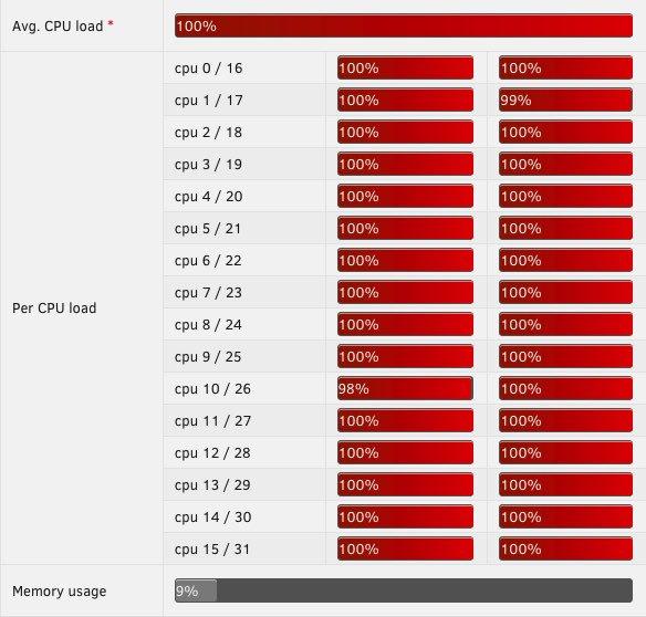

What’s nice about having tons of cores working on a encode is the speed and quality of which you can throw at the video. Transcoding can take a very long time depending on how you have configured Handbrake (more on this later). For me, I have the transcode set to as close as possible to lossless. This type of work requires a great deal of system resources (mostly time), look at how much both CPU’s are working on this 1 minute 12 second 4k video:
![Cpuspegged](https://craftassets.unraid.net/cache/awss3cloudfront/411/cpusPegged_1de723aec2edcea53c6e98b9d05ab2fe.jpeg)
That is 16 Cores and 32 Threads at a whopping 100% usage. Absolutely incredible! This setup will churn through tons of video footage while I work on other things.
