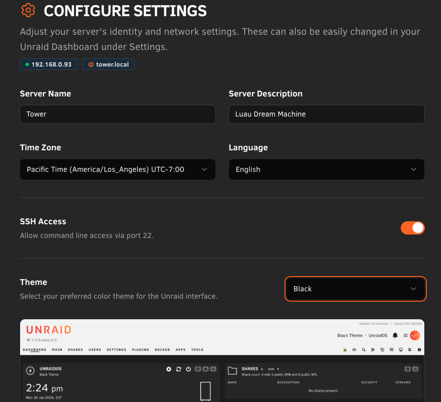

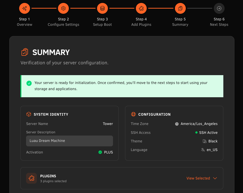

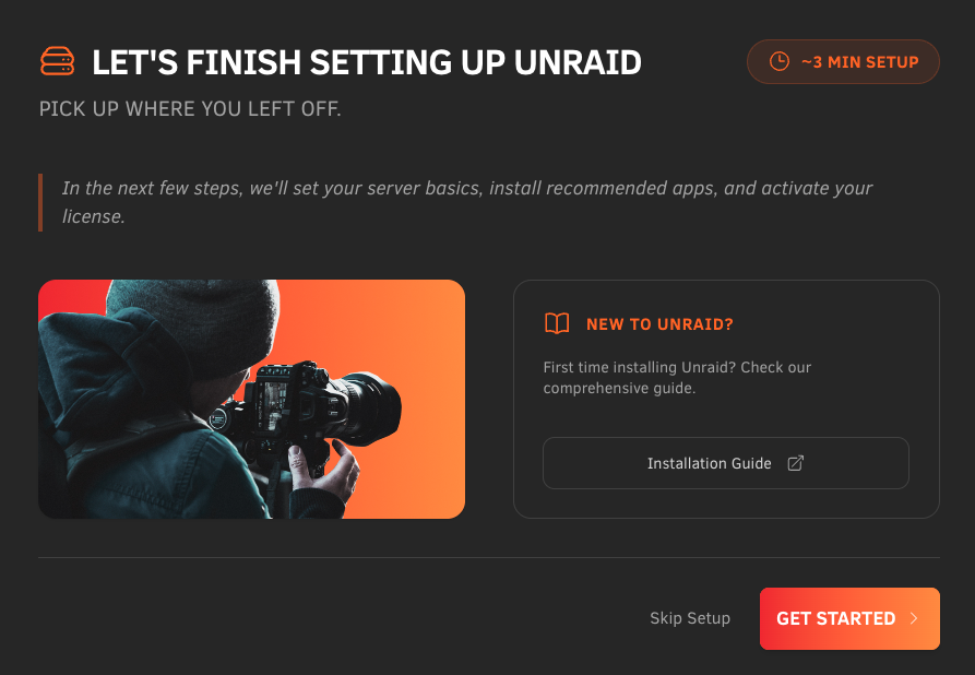

First-time setup now runs through a proper onboarding wizard: language, time zone, theme, activation code, and boot option all in one guided flow. If you're an existing user, you can revisit it any time under Tools → Onboarding Wizard, which is also the path to migrate an existing install to internal boot.
Internal boot itself gets promoted to a distinct option, with dedicated boot pool support separate from split boot pools. We've also cleaned up the language throughout. What used to be "Flash" is now "Boot" in most places, because your boot device doesn't have to be a flash drive anymore.
